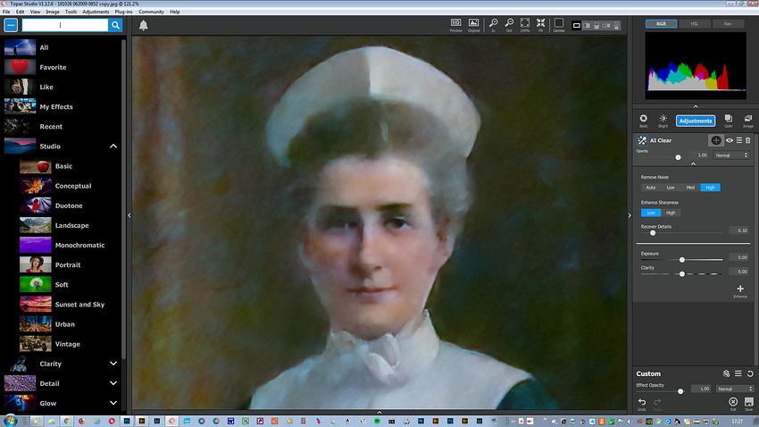

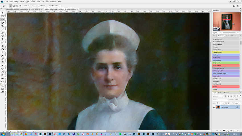

I have just purchased AI Clear and the saved result from the first image I processed is not very good. AI Clear does a reasonable job (see screen grab) but when I safe the image and open it is Photoshop (see screen grab) the file is full of artefacts that didn’t show up when the image was being displayed in Studio. This never happened when I was using the trial version. I tried saving the image as a TIFF and got similar artefacts.
