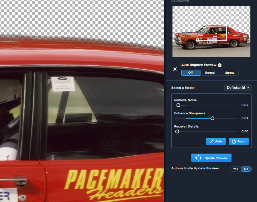

Hi Greyfox, I have no doubts you somehow were able to get DeNoise AI to save a transparency image. What I have a problem with, is that I can’t. Here are snips of the image with the transparency and the second after being pulled into DeNoise AI. Be sure to click on the second image to see the full image including the Denoise settings.

Your second screen shot shows that the image in DenoiseAI does not have the checkerboard pattern in either the navigator or the main screen, which leads me to believe that the area around the car is not actually transparent.

The image as opened in DenoiseAI should not have the white background if it has transparency. It should either be checkerboard if the preview has been updated, or black if it hasn’t been updated, so as I see it, the problem is what is being opened in DenoiseAI, not what is being saved from DenoiseAI.
Using a screen capture of the car with a white background I created a tiff file in Affinlty Photo that had a transparent background and saved it. I then opened it in Denoise AI and it kept the transparency. After processing I saved it as a tiff file and brought it back into Affinity Photo and it still had the transparent background.
