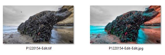

I may be having similar problems with saving files.
This was discovered in an attempt to import files into Lightroom and saving different file versions from Studio.
TIFF file saves seem to keep the image fidelity, but JPG and PNG saves throws off the colors.
The image on the left is the good one, and the one on the right is with the colors thrown off . . . and the PNG file save looks equally bad.

It looks like the color profile changed. Which profile is used on the original vs the output PNG and JPG files?
Can you help me better understand “color profile?”
When I save as a JPG file, I see no options other than “Image Quality.”
And PNG saving has no settings other than save.

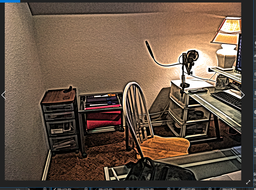

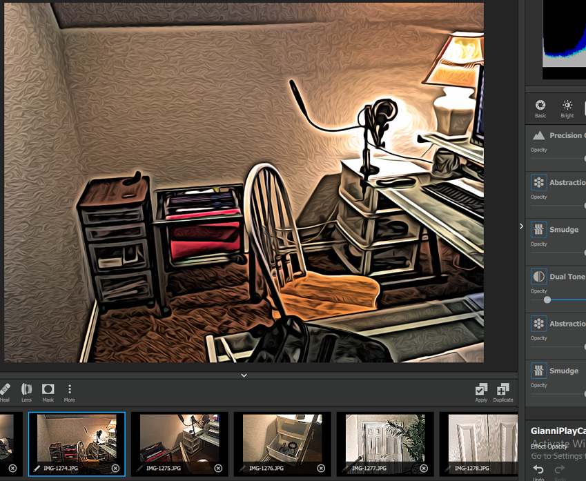

I opened a photo yesterday in Impressions from within Studio. I like the preset thumbnail for Chalk Smudge II so I worked with that (BTW, I don’t like how the thumbnails are presented in studio compared with the stand alone impressions…). the preset on the large photo looked nothing like the thumbnail but I worked with it anyway. After getting a look I thought I’d like I sent it back to photoshop, where it looked nothing like what I had worked on in Studio! After trying various combinations of working with it in Studio, I gave up and just went to the stand-alone impressions. I did not do screen shots since by the time I identified that there were indeed problem(s), it was beyond screen shot time. Just wondering if this is a consistent problem that someone already knows about?:
